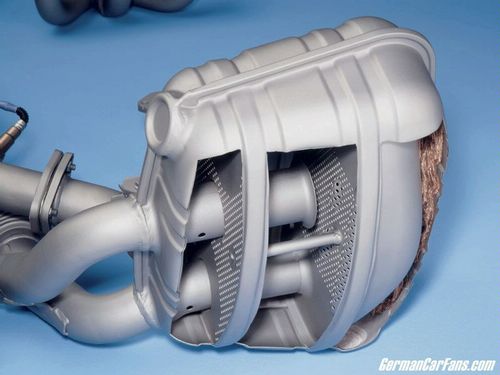

Raven Posted 4February, 2019 Report Posted 4February, 2019 I hope you like drone ,,,they are really only something you would want on the track ,,for normal street use the drone in the cabin will drive you crazy ,,it is really bad sounds terrible ... try after market system ,,,,X pipe or just mufflers.. or alternatively do a Fister D or Gundo mod on the OEM mufflers .. Fister D mod 1.3/4 inch bypass pipe ,,you can go as large as 2.5 inch cut away of OEM mufflers

TINGY Posted 5February, 2019 Report Posted 5February, 2019 1 hour ago, FR290 said: I'm on the verge of doing the Gundo hack, but would really like to hear the sound in person first... Anyone with the mod in Sydney that's available to demonstrate the sound (preferably on a 997.1 Carrera S)? The Gundo is a cheap mod that sounds ok and i think worth doing for some extra bark, not droney on the freeway either, mine is a 996.2.
