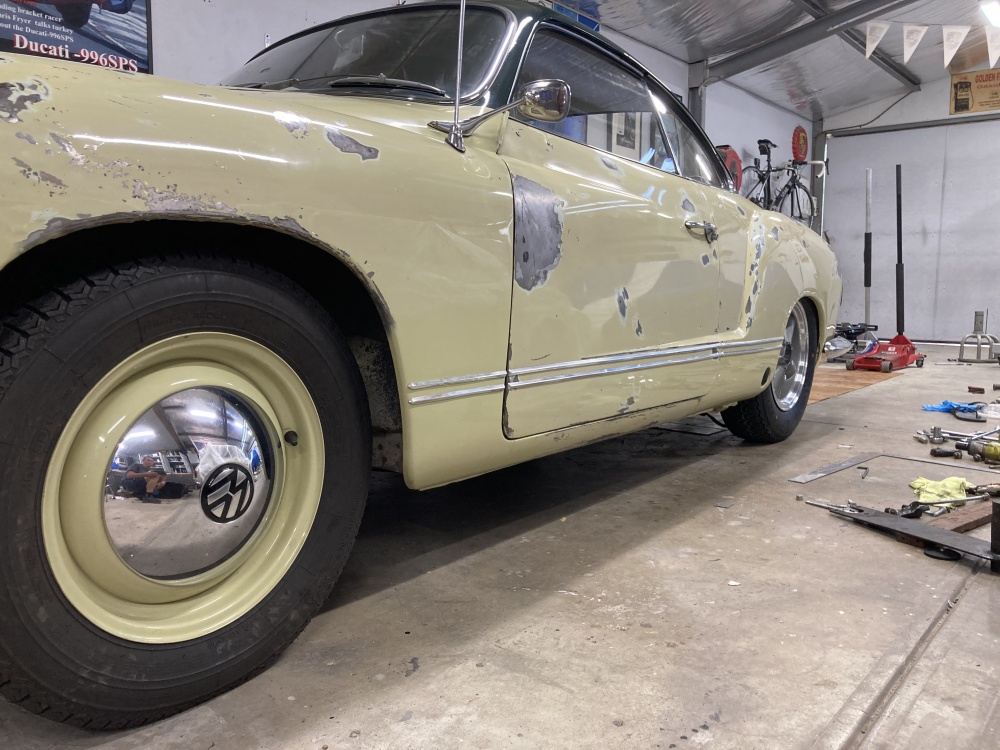

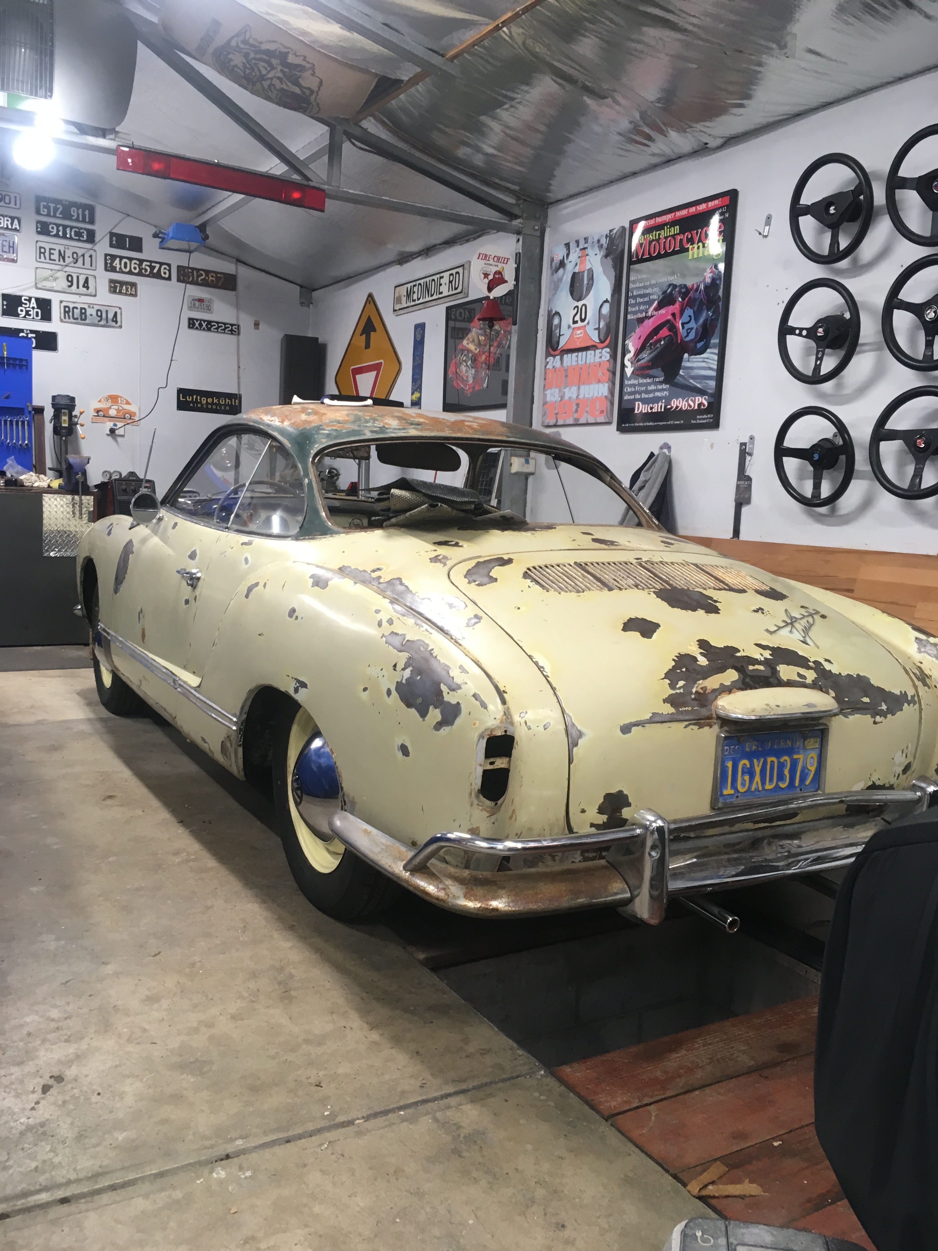

9er Posted 3September, 2019 Report Posted 3September, 2019 I have a 1959 Karmann Ghia which was the final year of production. They are known as Low lights and were only ever made in LHD and were not sold in Australia. Australia first go t Karmann Ghias in 1960 with the newer body style. I bought mine out of California in September last year and eventually got it shipped here in May (long story) Anyhow I know there are plenty of VW fans on here and also people who like picture driven threads so I thought I would record the journey here as I try to retain some of the 60yr old patina but also bring it up to a nice solid driver standard. The mix of old and new might not work and I may change my mind down the track but to get it up and driving that is the direction I'm heading. I was able to get it running after checking everything over however the asbestos checks in LA seem to have involved removing the brake shoes and calling it job done so I had quite a job of getting the brake system back up to speed. Front and rear suspension done with new link pins and king pins up front. First job was door hinge pins, followed by rear floors, then I tackled a dodgy repair to the RH front fender, where it seemed easier to cut a new body line with an angle grinder than try to rework the existing line. Front trunk had a rusted rear wall and spare wheel floor, and the ridge on the front nose needed tlc. Replacement rust panels are cheap and easy to source and the fit was good. I have bought new bumpers also. I disassembled all the seat frames and replaced broken springs and the sandblasted and repainted, ready for the new upholstery that I sourced from Lenny Copp in the USA, super expensive in VW terms but quite reasonable compared to Porsche stuff, and great quality. The roof paint is too far gone to be saved so I am just in the process of buzzing it all off after which I will be able to fit the new headliner and refit the front and rear windows with nice new seals. Picture of the car in LA By the time it got here things looked a little worse for wear. The car colour is Bamboo green with a Dark green roof. Airhead, 81SC, Dalai and 11 others 14 Quote

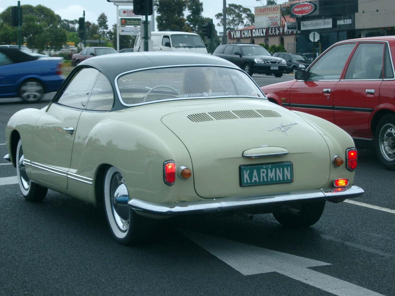

Airhead Posted 3September, 2019 Report Posted 3September, 2019 Love a good low light. Here's one we prepared earlier. Same colour too. GTP911, 9er and P-Kay 3 Quote

9er Posted 14September, 2019 Author Report Posted 14September, 2019 more Pics of progress. LeeM and Dalai 2 Quote

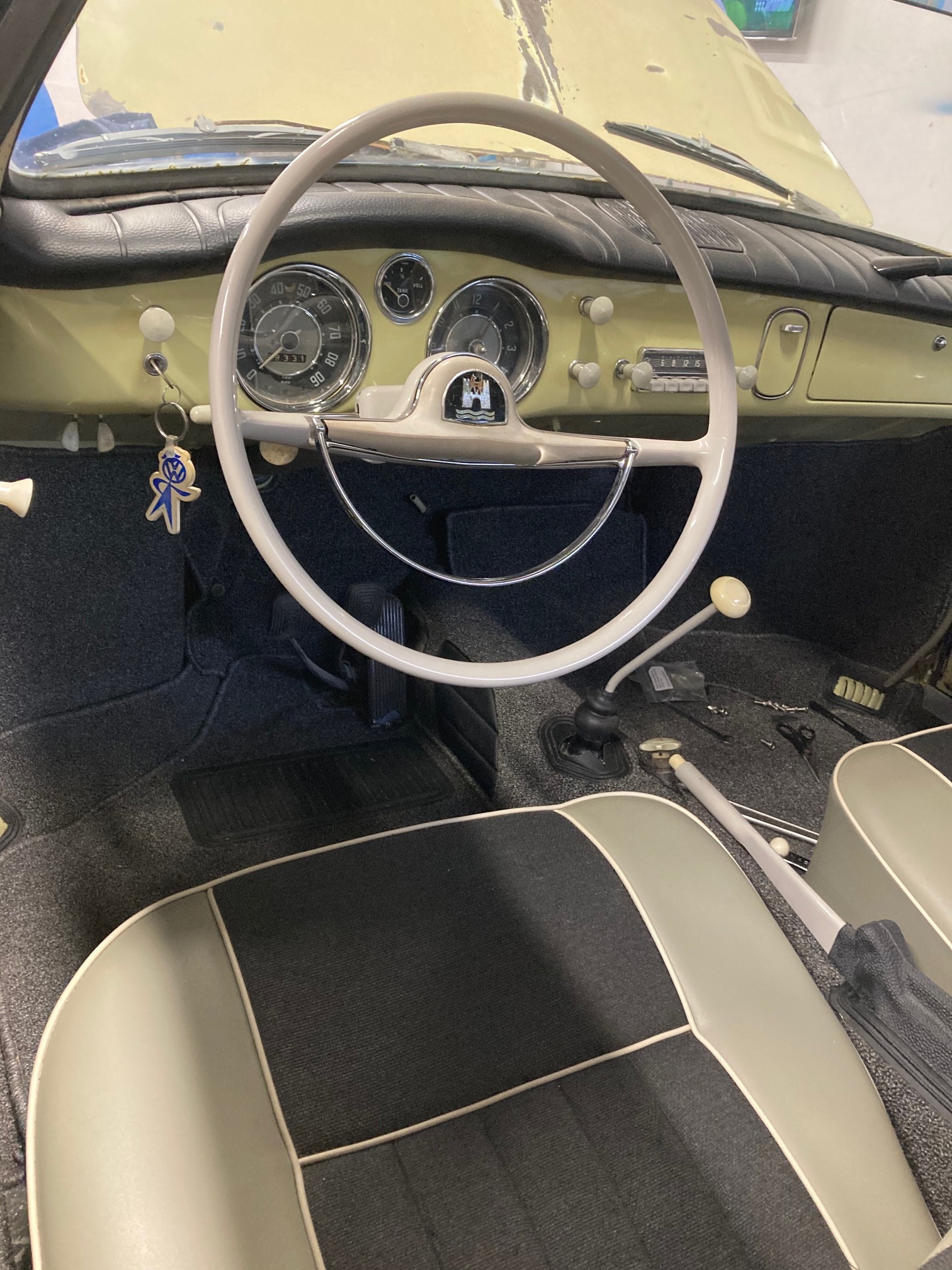

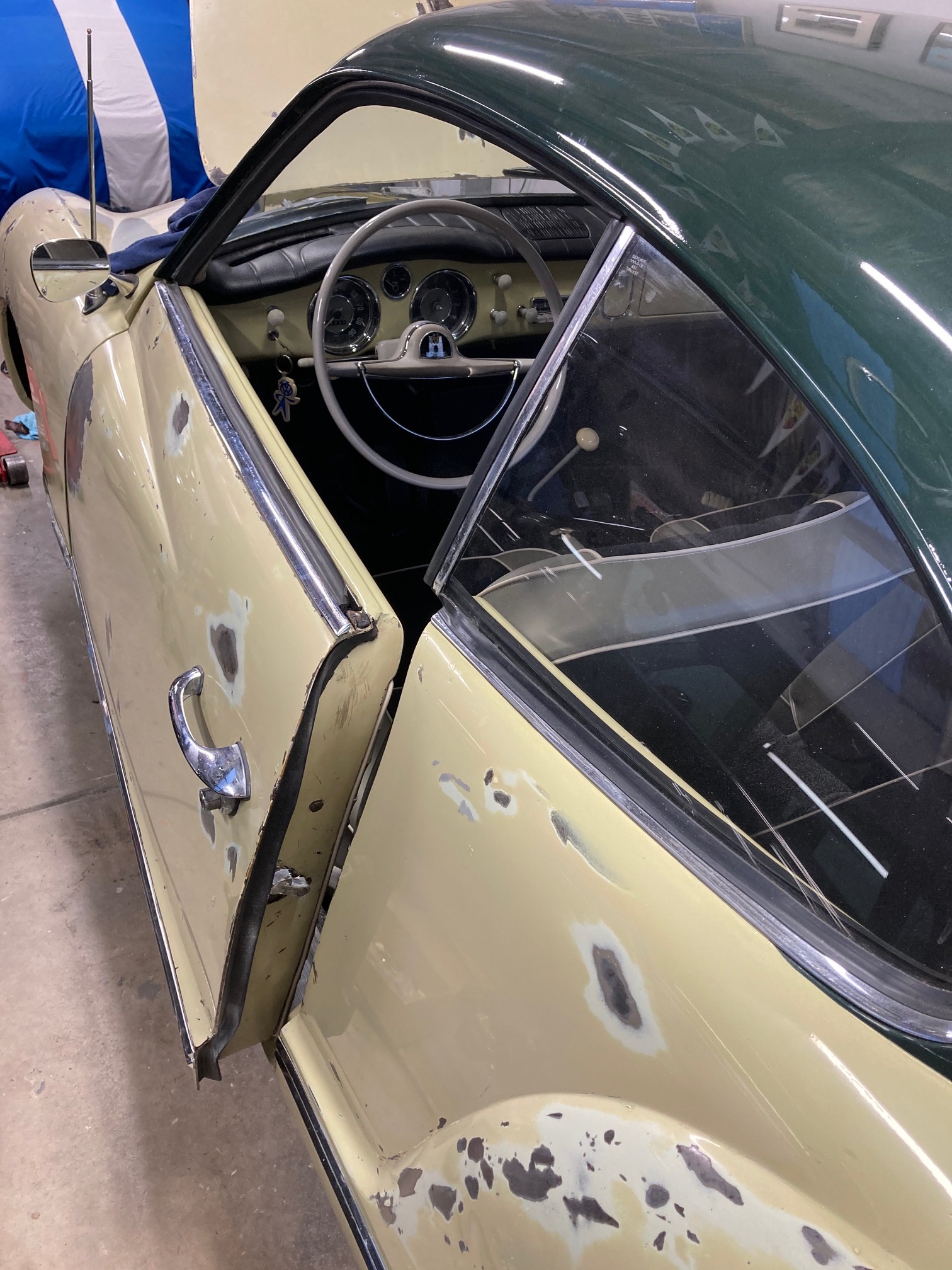

9er Posted 14November, 2019 Author Report Posted 14November, 2019 Roof painted. Seats reassembled with new springs and padding Rust in battery area and both lower rear wheel arches done Still a bit more to do Might even be driving this very soon. wilson59, OBRUT, 81SC and 7 others 10 Quote

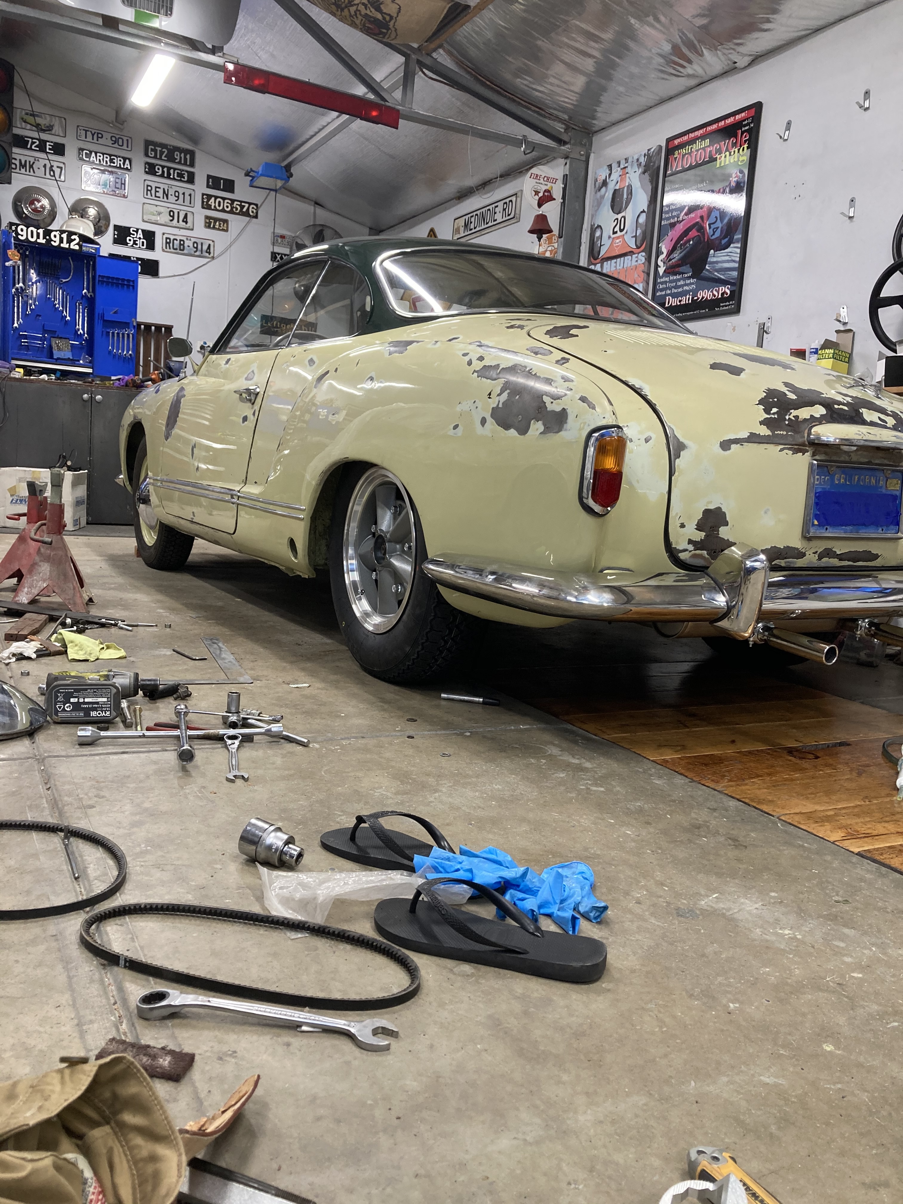

9er Posted 12January, 2020 Author Report Posted 12January, 2020 A bit of progress on the rear fenders, Karmann Ghia are a complex body shell structure compared to other cars I've done. Dalai, hugh, LeeM and 2 others 5 Quote
9er Posted 31January, 2020 Author Report Posted 31January, 2020 Some progress, metalwork, body and paint finished, so I can get the eBay spray booth out of the garage and reclaim some space. Engine back in, new wiring loom, and starting to put the interior together Dalai, 81SC, wilson59 and 6 others 8 1 Quote

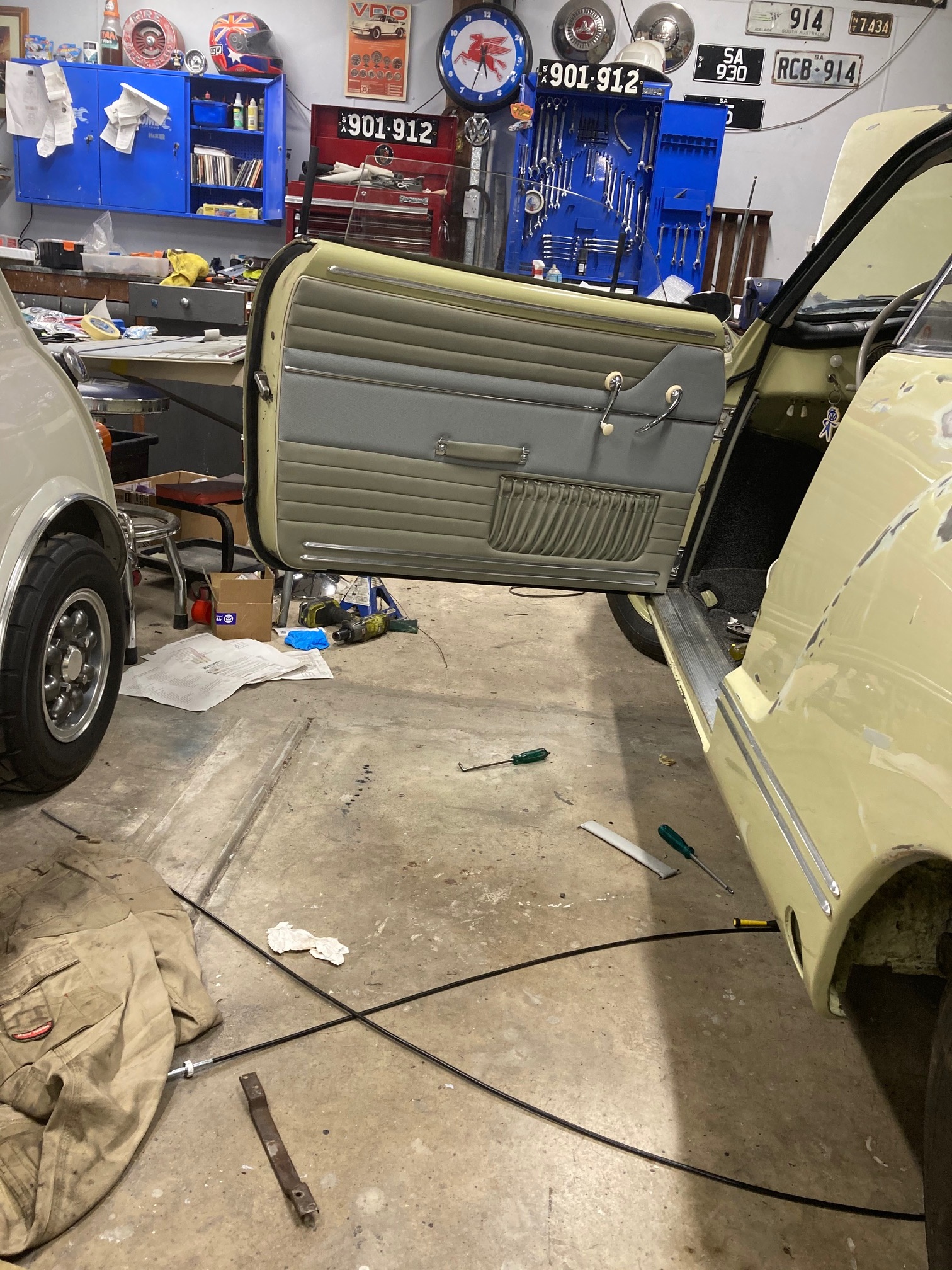

9er Posted 14February, 2020 Author Report Posted 14February, 2020 Getting slightly quicker at headliner installs and windscreen replacements, but carpet kits are just 3 hrs of glue sniffing. It's now running and driving. Dalai, P-Kay, Airhead and 4 others 7 Quote

9er Posted 22September, 2020 Author Report Posted 22September, 2020 I have really been dragging my feet on this one, partly due to sourcing a few parts, but anyhow its ready to face the authorities to seek registration. Harsh, Dalai, P-Kay and 6 others 9 Quote

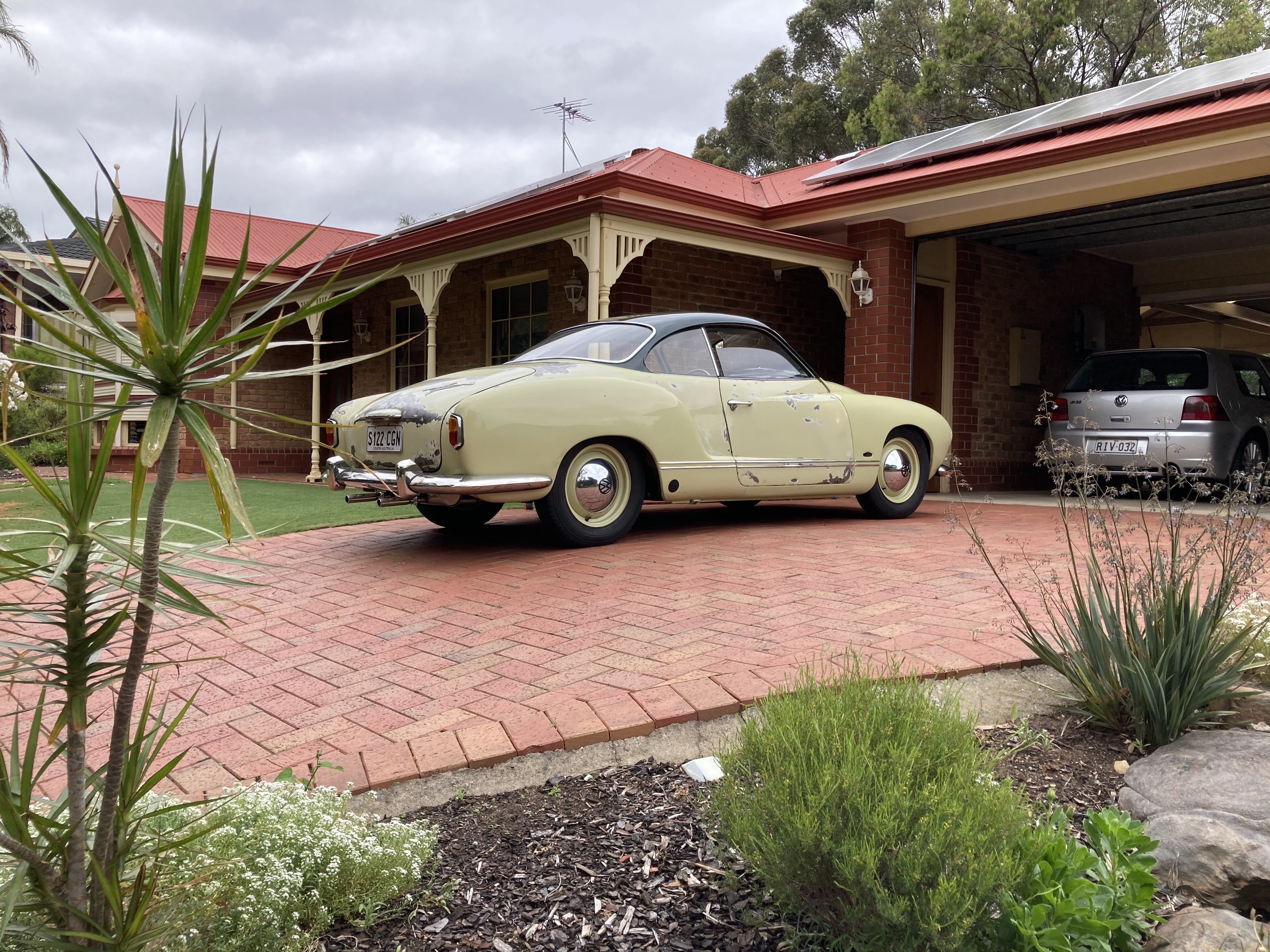

9er Posted 3November, 2020 Author Report Posted 3November, 2020 On the road and legal😃 Time to build the "Okrasa" motor now. Troubleshooter, brian in buddina, Dalai and 5 others 7 1 Quote

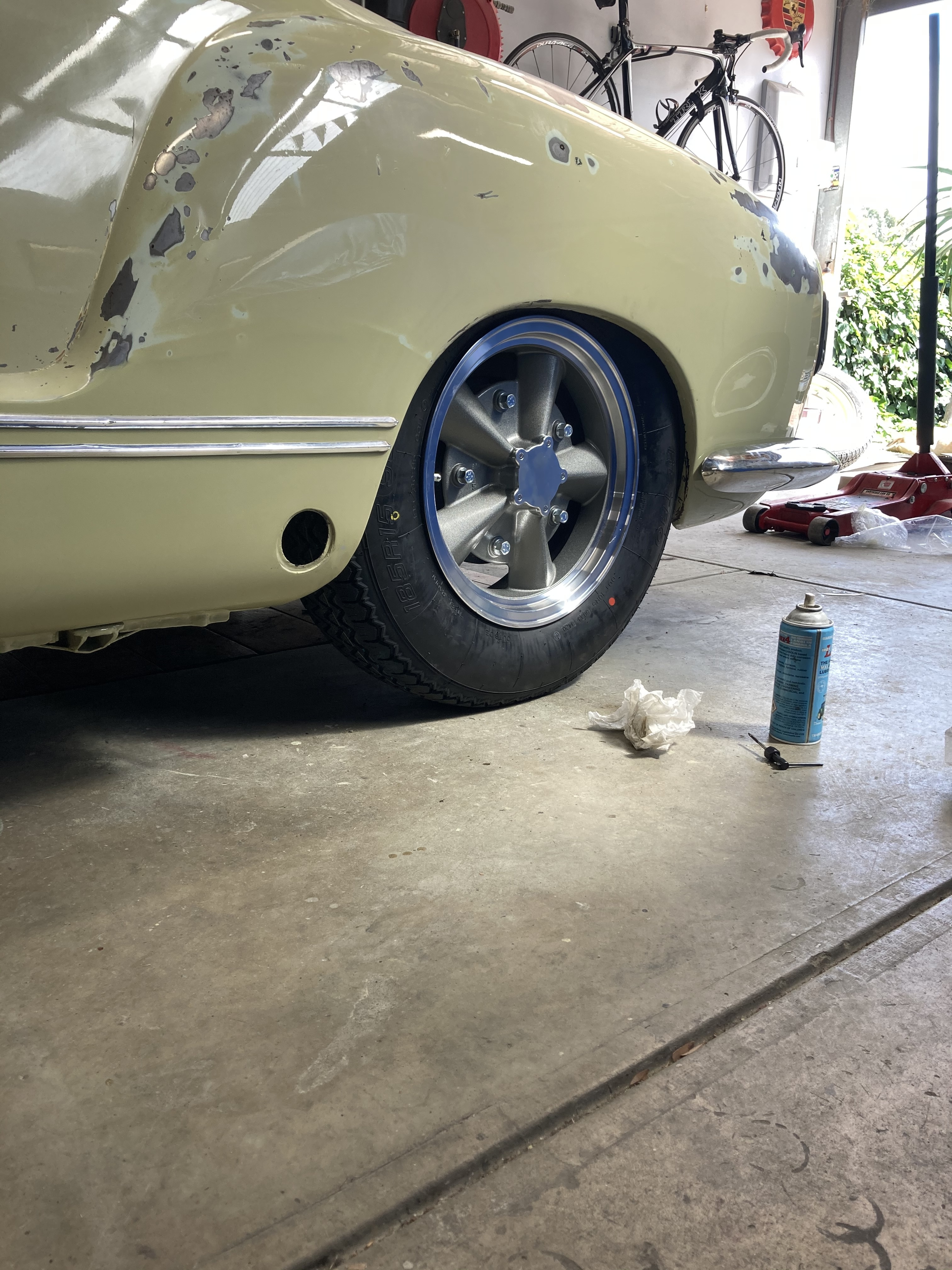

9er Posted 4November, 2020 Author Report Posted 4November, 2020 I found a set of NOS Enkei Flat 4 wheels from Japan and sourced some machined caps but I'm having second thoughts about moving away from stock wheels. I have been able to get the rears to fit and just about to get to work on modifying the front steering and suspension to make fitment possible. hugh 1 Quote
Nikos Posted 4November, 2020 Report Posted 4November, 2020 As much as I love stock, those Enkei's look hot. Due to the contrast of old v new, they actually make the Ghia's body stand out more. Troubleshooter and 9er 2 Quote
