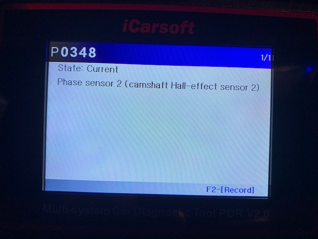

Fishcop Posted 8August, 2021 Report Posted 8August, 2021 Hi All I'm getting one of those occasional "bank 2 camshaft" error codes when I scan my engine. I've cleared it twice, but it comes back. Homework indicates there is a good chance it's just a wiring issue as the hall effect sensors don't fail too often (but they are a cheap replacement @ $150). Bank 2 is driver side at the front - but there's a heap of ancillaries to get through to get to the sensor. I'm wondering if anyone else has had a similar issue and whether there's a tips/tricks? Ta Quote
Peter M Posted 8August, 2021 Report Posted 8August, 2021 What's the actual error code it is giving you? Quote
Fishcop Posted 8August, 2021 Author Report Posted 8August, 2021 1 hour ago, Peter M said: What's the actual error code it is giving you? Hi Peter, it's showing P0348 Quote
Fishcop Posted 15August, 2021 Author Report Posted 15August, 2021 A little update... Bank 2 is the right side of the engine (looking at it from the back) or RHD driver side. And the sensor is at the gearbox end. I say this as half the material I found had different meanings for "driver side" and what people consider the "front" of the engine. Pulled the sensor (that's a fun job - so pleased I bought the mechpro low profile ratchet) - make sure you fish out the O ring too. I followed some Youtube demos on how to test a hall effect sensor (3 wire) using just a multimeter. Pretty sure I found my sensor worked only intermittently, which would back up the code being thrown. In any case it's sufficient doubt to warrant purchasing a replacement - it's a standard Bosch unit found across a lot of euro cars and priced around $120 delivered from one of the online shops, so a new one is ordered. So prior to my coil packs failing earlier in the year, there was a very minor and intermittent "lope" when the engine idled - I put this down to a coil, and solved with the replacement 997 units as recommended by Porsche. But I'm reading that a failed camshaft phase sensor can also upset the DME from keeping the engine tuned right - I'll be interested to see whether I notice any real difference from what I think is a pretty well running engine. P-Kay, 911CSR, st3ve and 4 others 7 Quote
Fishcop Posted 23August, 2021 Author Report Posted 23August, 2021 Holy Shit! I replaced the Hall Effect sensor (phase sensor) on bank 2 and cleared all codes. Took it for a run, and the difference was astonishing... Clearly this sensor hasn't worked during my ownership, so the car's DME has been managing the engine on a 'safety curve' and holding the VarioCams at a constant setting. Now the car is obviously adjusting the cams through the rev range and I 'feel' like I just scored an extra 50hp low down 2-4k and another 20hp running out to 6k. I'm stoked! Running the scanner over the engine and there are no more error codes. Woot woot. Costas, TwoHeadsTas, Redracn and 6 others 8 1 Quote
