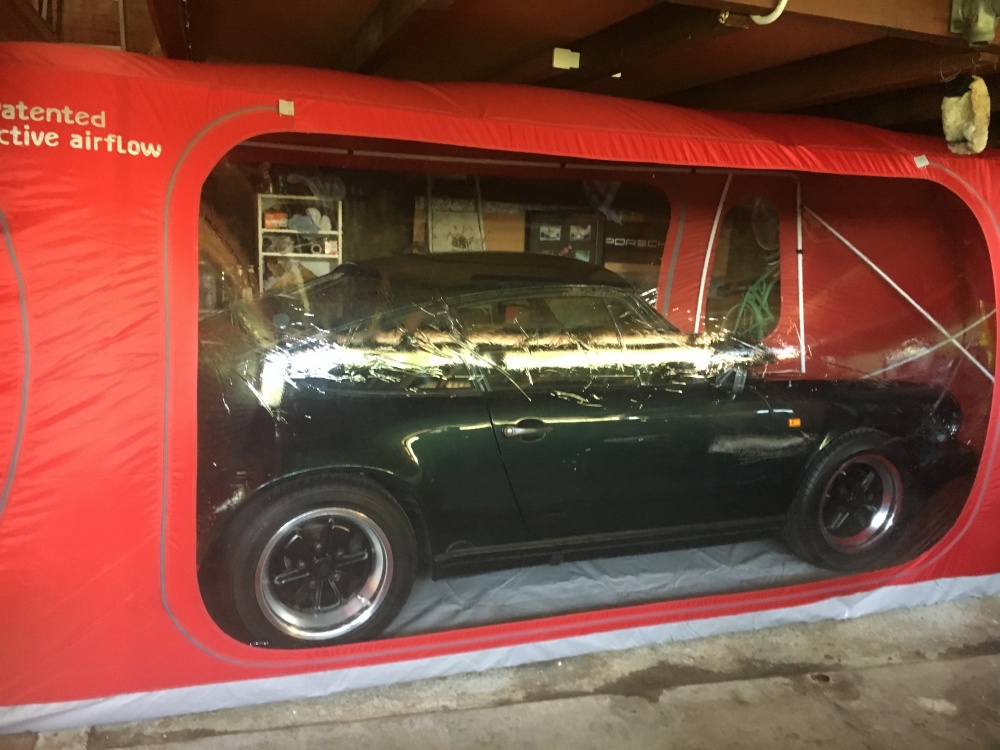

mal911 Posted 14September, 2021 Report Posted 14September, 2021 Hi Wangan I had the very same issue with my previous property so I purchased a car cocoon that worked fine for aprox. 4 years. Quote
911 Posted 14September, 2021 Author Report Posted 14September, 2021 36 minutes ago, mal911 said: Hi Wangan I had the very same issue with my previous property so I purchased a car cocoon that worked fine for aprox. 4 years. Thanks for the reply @mal911 Is it expensive to run? It's a good solution solely for the car, but ideally I'd like the whole garage to be like that, so that I can leave tools and whatnot inside without having moisture issues. I've read about dehumidifiers, but it's very expensive and not the most effective if you're using the garage regularly. For reference here's a snap of my garage. Roof has a very high pitch, not sure if that makes it better or worse. Quote
