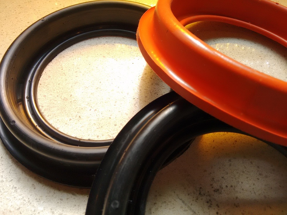

911_sporto Posted 9December, 2021 Report Posted 9December, 2021 It may be a small fracture in the vacuum servo diaphragm due to age or use. These have a habit of sealing intermittently- until the hole becomes too big to self seal. If you stick your head in the engine bay, you should be able to possibly hear or feel the big solenoid in the control valve "clicking" when the gearshift is moved, when the motor is not running but the ignition is on. (Much harder in a post 72 car as the valve is under all of the CIS stuff....) More unlikely - It could be a loose lock nut or other play on the servo actuator linkages or low vacuum due to a failed check valve or inlet leaks. Quote
Manni187 Posted 9December, 2021 Author Report Posted 9December, 2021 Great info - I’ll have a look tomorrow. I don’t think the vacuum diaphragms are available new anymore. I had the engine leak tested and replaced all lines and intake boots including injectors, seals, plugs, gaskets, sensors, leads, coil, cdi, dizzy, filters, accumulators ect replaced recently. I am surprised the diaphragm can intermittently fail like that. I’d also love to buy a new vacuum valve but again I think they are nla. Quote
911_sporto Posted 10December, 2021 Report Posted 10December, 2021 I had a limited number of these professionally made by a rubber manufacturer here in Brissie. In both nitrile rubber and red silicone I think that I still have a couple left- if you end up needing one. Quote
