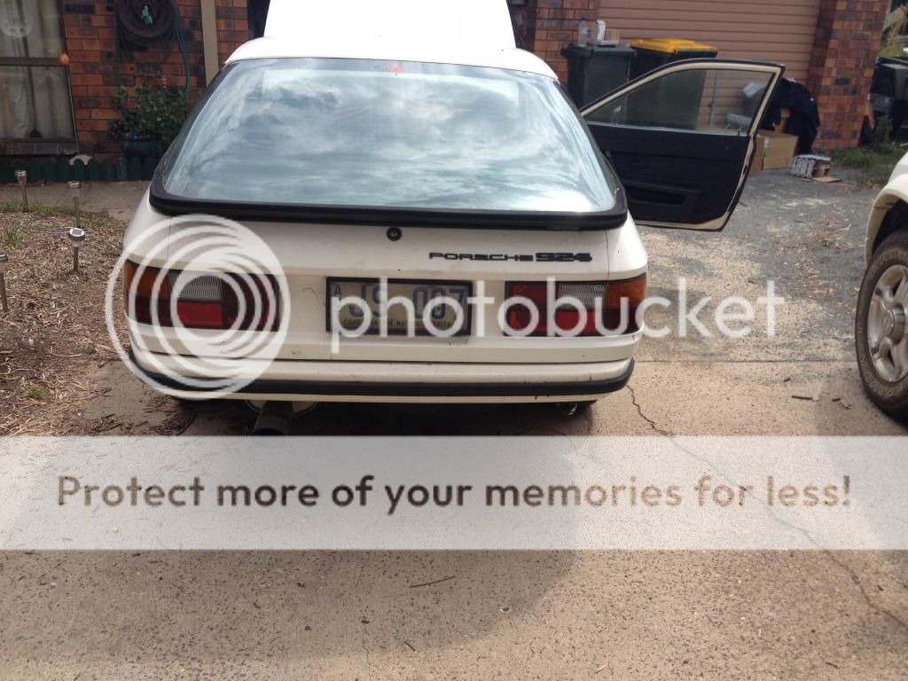

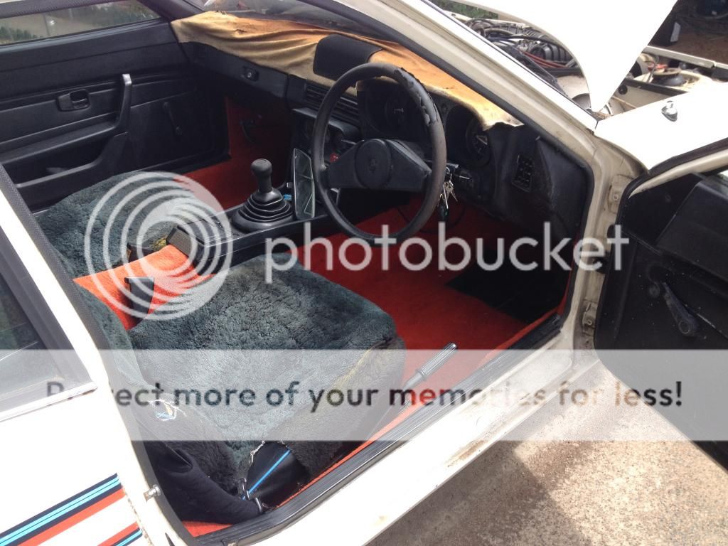

Mikey1st Posted 17February, 2015 Author Report Share Posted 17February, 2015 So i hit my first speed bump, mainly cause I'm not a very good mechanic and my tools are rubbish. Sump plug bolt is rounded badly... tried treaded sockets with no luck, tried vice grips with no luck, will hit up the neighbor on Wednesday (my day off) to see if he has any tricks. Anyone here got any? And here are the pics Link to comment Share on other sites More sharing options...
Caledonian Posted 17February, 2015 Report Share Posted 17February, 2015 Yeah! Pics.... Looks worth saving from what I can see, sure your neighbor will have solution for the sump plug. If you want suggestions from hear(be carful what you wish for) Link to comment Share on other sites More sharing options...
