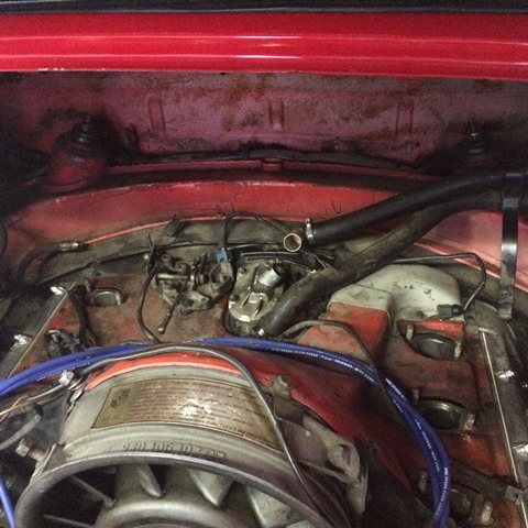

Chevl Posted 21September, 2015 Report Posted 21September, 2015 Hi I bought a 911sc 1983 about 9 months ago and it has been great until now.Problem:it is running rough when I start it cold and need to have my foot on the accelerator for it not to stall. However it does start.how it started:drove home from work and it was running fine. Stoped at a petrol station on the way home and filled it as it was almost empty.next morning when I started it, it was very roughwhat have I done so far:changed leads as per the manual I have, they where over 3k ohms.changed spark plugs and rotorchecked cdi and it has the high pitched sound I also found an invoice from the previous owner for almost $4k to replace the cdi in 2013 so I'm assuming it is finechecked coil and resistance is within spechave not checked fuel preassure yet as I went to several places to buy a fuel pressure gauge and no one had one. ( would appreciate if someone could suggest where I can guy a tester in Melbourne)would appreciate any help/suggestions to get my car back on the road. cheers Anthony

Chevl Posted 23September, 2015 Author Report Posted 23September, 2015 So i went and turned the idle mixture screw about 1 full turn ant clock wise and it is idling fine, a bit high. i didn't want to adjust the idle screw yet. Now the question is:Why did the idle mixture screw need adjusting all of the sudden? Can it wind it self clock wise by itself?When warm it was idling at about 1000 rpm and the oil level was a bit high on the gauge. So the next question is:Because it was running so rich for who knows how long could i have a bit of fuel in the oil? I will now wait until i get the gauge and test fuel pressure and then try and adjust as best i can the air fuel ratio and take it to someone for the final adjustment and get the valves adjusted as well. i know how to adjust valves but i have never done it on this car i would like to see it done before i embark on that project.

Chevl Posted 26September, 2015 Author Report Posted 26September, 2015 Ok got the gauges on friday and installed them today. Had a few issues, first of all they leaked fuel initially through the quick release and then it sorted itself somehow. The next issue was despite the fuel relay bypassed the fuel pump would not kick in until i moved the airflow plate.Anyway i tested the System pressure first and it would go to 5 bar (72psi) and then drop to 3 bar (43psi) when i let go of the airflow plateI then went to test control pressure and it was about 1.2 bar (17psi) went i started the car. It starts straight away however it sat at 900 rpm when cold.And it took about 5min to get to 4.2 bar (60psi) and stayed there how ever there was hardly no change in rpm i believe it got to 950 rpm max.The car sat for about 25 min and the preassure dropped to 1,2 bar (17psi). I then started it warm and it started straight away.So i thought the fuel pressure seems fine, i shall continue to look for vacuum leaks. This time i put a hose through the side hole of the airbox and put it through the airflow plate. I then put the filter in a plastic bag and got a friend to give me a cigarette with which i blew smoke into the air box. and after puffing into it i had smoke come from behind the airbox i believe it was the hoses that connect to the auxiliary air valve, which i have tightened. I then started the car and it is still the same. By this time i had run out of the cigarette. I shall try tomorrow again.Do you think im on the right path? Just a vaccum leak? Could this be the cause of low rpm with hardly no change when engine hot? By the way if someone needs fuel gauges im happy to borrow mine
Chevl Posted 6October, 2015 Author Report Posted 6October, 2015 On the weekend i removed the TTS and the CSV and bench tested both. When cold the TTS would activate the CSV for about 3 seconds and then turn it off. When it was over 45 degrees it would not activate the CSV.I thought maybe i had a leak with the CSV however i put air through it and put the end under water and nothing came out. It was so complicated to remove and install the CSV, i doubt i do it again soon, however i have learnt so much about my car. I'm not a mechanic but i consider myself to be mechanically minded. Anyway i went to look for help as this is my daily driver and i need it back on the road. i went to see nIck castone first but he can not see my car until next week. So i then went to Shaun from Jocaro Motors who also specializes in P and he organized a tow truck to pick it up yesterday. So hopefully soon he will be able to tell me what has happened to my car and have it back on the road.

Chevl Posted 8October, 2015 Author Report Posted 8October, 2015 They found that it was the fd that is playing up and suggested that we re build the fd and wur and get them calibrated. They also said that we should clean injectors and check valve clearances.They are going to give me a price to do all of that work. Any idea how much you think it will cost me?
Russ Posted 8October, 2015 Report Posted 8October, 2015 i had my fuel distributor rebuilt last year for $600, not sure about the cost of the warm up regulator
Chevl Posted 9October, 2015 Author Report Posted 9October, 2015 I have gone ahead with the quote i'm doing a bit more than maybe necessary, however i want to have peace of mind:Parts:$380 WUR$385 Air flow metre$715 fuel distributor$59.28 clean fuel injectors$69.89 Rocker cover gasket setLabour:$292.50 Carry out checks to find problem$702 Replace all fuel system$351 Adjust valve clearances and replace oil and filter$145 tow truck$3099.67 Total
Chevl Posted 23October, 2015 Author Report Posted 23October, 2015 So far they have done the valve clearance and checked if i had broken head bolts. Thank God they are fine. i bought the firewall lining and hopefully the full intake will go on once everything has been rebuilt.
