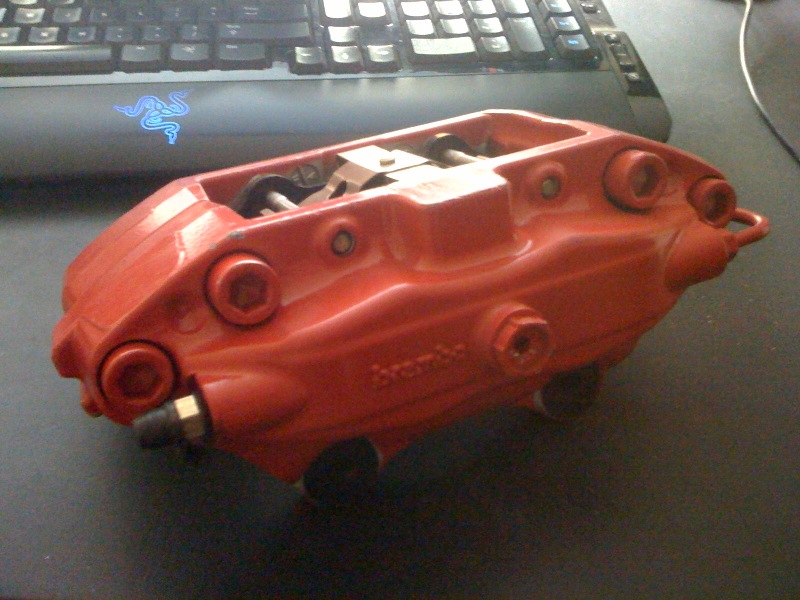

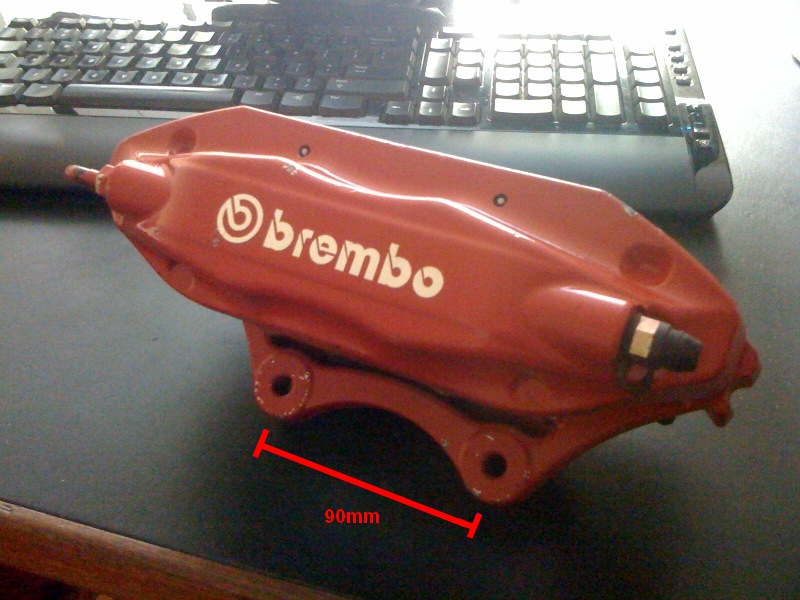

Wobbly Posted 26May, 2010 Report Share Posted 26May, 2010 Hey folks ... got a bit of a quandary. The brakes on my 74 911 seem to be less than stellar, and require a whole lot of pedal pressure to get to work. While I'm sure things could be improved with flushing, line replacement, pads, discs, etc, I've got it in to me that what I really need is much shinier bling bling brakes I bought a set of brembo 4 spot callipers a while ago and thought I had fallen into some good fortune, as they seem to measure 90mm from eye to eye which means they should just bolt straight up to the 911's 3.5" struts. Awesome! Unfortunately my 911 still runs the old strut bolt spacing (75mm) so this isn't much good for me. I can either try and find some used later model struts with the 90mm spacing that should match the calliper ... or I could get the mounting lugs on the callipers cut and re-welded to suit (yikes) ... or I could sell these on to someone who has an SC or 3.2 (assuming they fit) and go for a set of cockster callipers with the right adapter brackets (easier since they are a radial caliper meaning that a backet for a 90mm mount can be relatively easily adapted for 75mm, and I could even look at varying the disc size from standard with the addition of a radial spacer plate). Any ideas?? Anyone want a set of brembos with 90mm centres?? Link to comment Share on other sites More sharing options...

Hung Do Posted 27May, 2010 Report Share Posted 27May, 2010 It's not a simple matter of bolting the caliper to your struts. I don't know what caliper you have (there are many brembo calipers) but in general for the front you will need an adapter to get the alignment with the rotors right. You probably would need a 3 piece front rotors kit to suit. The rears are even harder. I have fitted 993 calipers on a mid 911 before. There are various adapter kits and rotors for the front, the rears need machining work to the calipers but can use 930 rear rotors. Try google '911 brake upgrade bill verburg' there is very useful information about this topic. Link to comment Share on other sites More sharing options...
