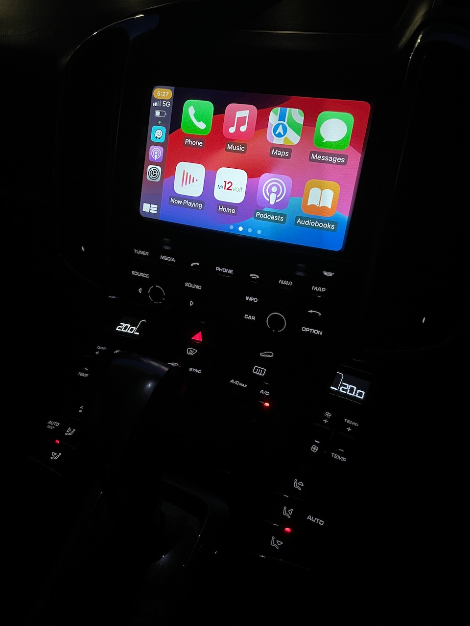

edgy Posted 27June, 2024 Author Report Posted 27June, 2024 On 07/05/2024 at 14:21, DieRooiGevaar said: Ha ha ha I'm quite familar with procrastination. Please do let us know - hell, even ahead of time because maybe some of us will join you while you're at it. I had to go and pick up the RS from the shop last week, so I used it as an excuse to actually dust off this box and do car swap to have fitted this CarPlay unit. I've only had it a couple of days, but it is really good I have to say... feels like OEM to me, the only thing I haven't tried is the radio app so I can listen to FM radio & use the waze nav etc for the $$$ it is a great option versus the expense of the PCCM+ unit I bought for my 997, that was a costly exercise (worth it), but the PCM 3.1 hardware in our cars is more than adequate for this mod... the car feels 10 years younger now. Miffy 1 Quote

edgy Posted 27June, 2024 Author Report Posted 27June, 2024 26 minutes ago, DieRooiGevaar said: So @edgy you did it yourself? If so, difficulty of installation? Tell us more! I gave it to the guys at PR tech, they said it was very straightforward, perhaps a few hours at best… sorry I’m not much more help than that! But I bought it via Roman @ ACS on rennlist, his comms & support were great and he would guide you through an install Quote
