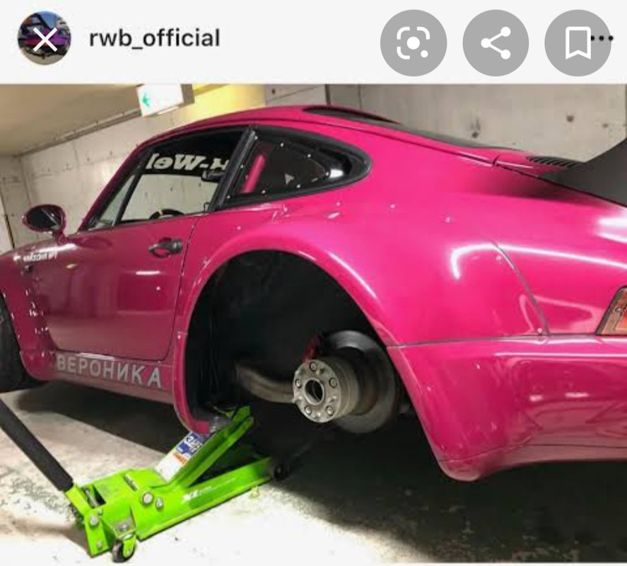

Cheshire Cat Posted 21May, 2021 Report Posted 21May, 2021 22 hours ago, LeeM said: I couldn't telya Merv, though if you believe the internet, there is a possibility of bearing stress with the 50mm+ spacers like RWB's use. I'm no mechanical engineer, but you'd think with some very long wheel studs, they would be the first thing to be under stress, which I s'pose would eventually lead to bearing problems Well, RWB`s don`t use any spacers, and I read a while ago about engineering report (sort of) of using big (like 50+ mm) spacers and stress on the bearings, the idea is it is destroying your bearing but one could feel (hear) the problem on a relatively big mileage, like 50000+ km`s or so. In the case of Porsches esp on the air cooled ones - negligible On 19/05/2021 at 22:19, Doish13 said: Hope someone can help. Have a SC with 16’s on and slightly lowered. The rear wheel sit inside the guard slightly abs looking for a more flush look to fill out the guards. I know very little about spacers. Believe Porsche even sold these from factory / dealer (could be wrong). where do you buy them? Is one brand better than the other? Any recommendations? thank you FYI I have a pair of 10mm hub centric spacers laying around Quote

LeeM Posted 21May, 2021 Report Posted 21May, 2021 2 hours ago, Cheshire Cat said: Well, RWB`s don`t use any spacers You sure about that? Quote
Cheshire Cat Posted 21May, 2021 Report Posted 21May, 2021 15 minutes ago, LeeM said: You sure about that? not anymore lol those I`ve seen - not really. LeeM 1 Quote
LeeM Posted 21May, 2021 Report Posted 21May, 2021 10 minutes ago, Cheshire Cat said: not anymore lol those I`ve seen - not really. 😅 👍 Quote
