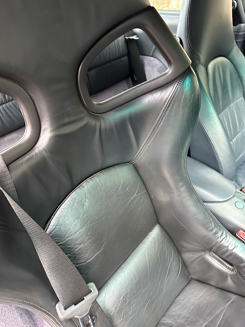

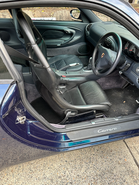

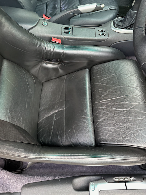

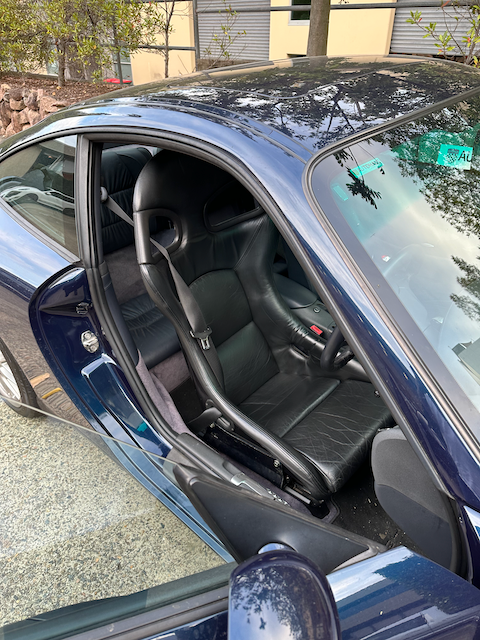

AndrewM Posted 5July, 2024 Author Report Posted 5July, 2024 I was never able to find a 997 2way sport seat. I ended up getting my hands on a 996 GT3 seat, and with the standard rails and brackets that come with it, I am still not really any lower due to how vertical you sit in the seats. I can at least take out the bottom seat cushion so I can sit in the car with a helmet on. I can probably get them a bit lower with the Brey Krause brackets, which are a bit lower, but also allow putting the seat on a bit more of an angle. The seats themselves are great for spirited driving as you can really feel how they keep you attached to the car! However, I feel that my shoulders are too wide for the narrow ears at the top of the seat, and feel like my shoulders are being pushed forward the whole time. I also found out that the Recaro sportster seats don't seem to provide any extra height... I will try it for another month or so, and if it doesn't get better, probably go back to the stock seats, and for the rare days I am on the track, just lay back much further. I recently installed a steering column extension, so I thankfully won't have to sit so far forward when leaning the seat back. Long term I will probably end up looking for a UK import, as a lot of them seem to not have sunroofs... Quote

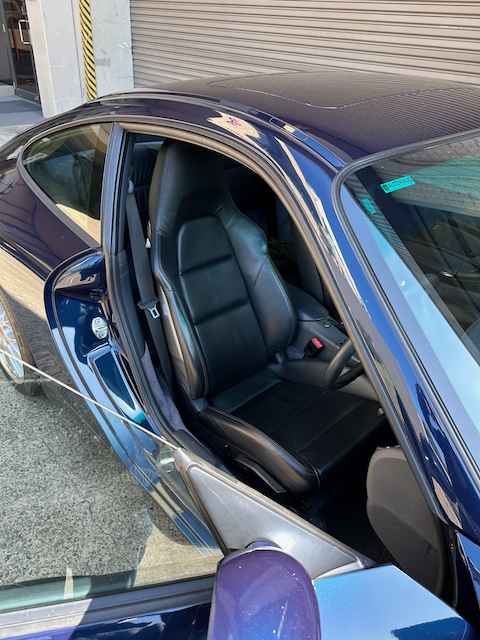

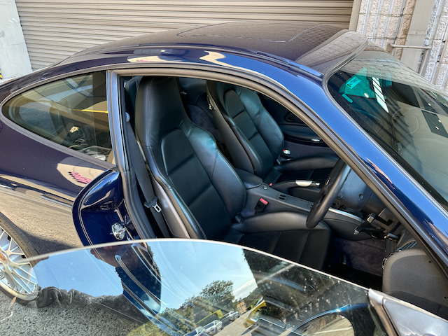

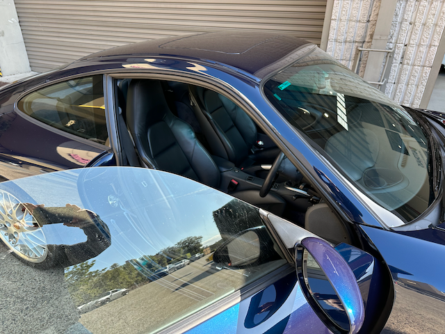

AndrewM Posted 23September, 2024 Author Report Posted 23September, 2024 On 06/07/2024 at 02:00, Carrera28 said: I reckon these are a great Porsche option in terms of both aesthetics and not being too racy, plus they are in Sydney so you might be able to go and sit in them: https://retroautotek.com.au/shop/recaro-seats-lxf-wu110-a-r-black-brand-new-pair/ Thanks! Will definitely have a look at this in the next week or so! 996 GT3 Seat in 996. And now, installed last week, 2 way seats from a 981: Quote
Carrera28 Posted 23September, 2024 Report Posted 23September, 2024 How are the 2 way 981 seats in terms of head room? They look great in your pictures. Quote
AndrewM Posted 23September, 2024 Author Report Posted 23September, 2024 The 981 seats are still too high, but better than than the original comfort seats. Will need to put on my helmet and give it a go. I might just get away with leaning the seat back a little more. This works now that I have the steering wheel extension installed - you may be able to see the black boss just behind the wheel. It does make grabbing the indicator a little unusual to start though! https://spacershop.com/en/prodotto/steering-wheel-spacer-for-porsche-carrera-996/ And yes, the 2 way seats look like they belong in there! As for the comfort, need to drive them a little longer. PS: I wish people wouldn't order sunroofs when they buy their 911s new, so I can pick up ones without later! 😄 Carrera28 1 Quote
